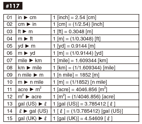

    01 in ▶ cm 1 [inch] = 2.54 [cm]
    02 cm ▶ in 1 [cm] = (1/2.54) [inch]
    03 ft ▶ m 1 [ft] = 0.3048 [m]
    04 m ▶ ft 1 [m] = (1/0.3048) [ft]
    05 yd ▶ m 1 [yd] = 0.9144 [m]
    06 m ▶ yd 1 [m] = (1/0.9144) [yd]
    07 mile ▶ km 1 [mile] = 1.609344 [km]
    08 km ▶ mile 1 [km] = (1/1.609344) [km]
    09 n mile ▶ m 1 [n mile] = 1852 [m]
    10 m ▶ n mile 1 [m] = (1/1852) [n mile]
    11 acre ▶ ㎡ 1 [acre] = 4046.856 [㎡]
    12 ㎡ ▶ acre 1 [㎡] = (1/4046.856) [acre]
    13 gal(US) ▶ ℓ 1 [gal(US)] = 3.785412 [ℓ]
    14 ℓ ▶ gal(US) 1 [ℓ] = 3.785412 [gal(US)]
    15 gal(UK) ▶ ℓ 1 [gal(UK)] = 4.54609 [ℓ]
    16 ℓ ▶ gal(UK) 1 [ℓ] = (1/4.54609) [gal(UK)]

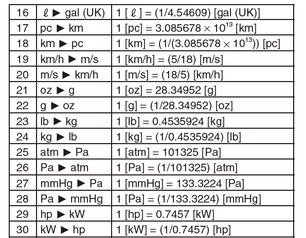

    19 km/h ▶ m/s 1 [km/h] = (5/18) [m/s]
    20 m/s ▶ km/h 1 [m/s] = (18/5) [km/h]
    21 oz ▶ g 1 [oz] = 28.34952 [g]
    22 g ▶ oz 1 [g] = (1/28.34952) [g]
    23 lb ▶ kg 1 [lb] = 0.4535924 [kg]
    24 kg ▶ lb 1 [kg] = (1/0.4535924) [lb]
    25 atm ▶ Pa 1 [atm] = 101325 [Pa]
    26 Pa ▶ atm 1 [Pa] = (1/101325) [atm]
    27 mmHg ▶ Pa
    1 [mmHg] = 133.3224 [Pa]
    28 Pa ▶ mmHg 1 [Pa] = (1/133.3224) [mmHg]
    29 hp ▶ kW 1 [hp] = 0.7457 [kW]
    30 kW ▶ hp 1 [kW] = (1/0.7457) [hp]

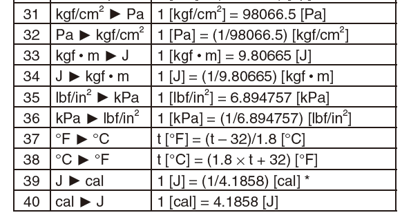

    31 kgf/㎠ ▶ Pa 1 [kgf/㎠] ▶ 98066.5 [Pa]
    32 Pa ▶ kgf/㎠ 1 [Pa] = (1/98066.5) [kgf/㎠]
    33 kgf*m ▶ J 1 [kgf*m] ▶ 9.80665 [J]
    34 J ▶ kgf*m 1 [J] = (1/9.80665) [kgf*m]
    35 lbf/in² ▶ kPa 1 [lbf/in²] ▶ 6.894757 [kPa]
    36 kPa ▶ lbf/in² 1 [kPa] = (1/6.894757) [lbf/in²]
    37 ℉ ▶ ℃ t [℉] = (t-32)/1.8 [℃]
    38 ℃ ▶ ℉ t [℃] = (1.8×t +32) [℉]
    39 J ▶ cal 1[J] = (1/4.1858) [cal]
    40 cal ▶ J 1 [cal] = 4.1858 [J]
