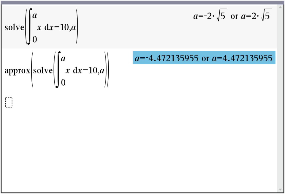

      2026.04.10 - 11:48 2026.04.10 - 11:28 #57103
      참값 : A = ±2√5
      근사값 : A≈±4.472135954999579392818347
      image.png 51.8KB 36
