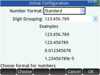

    1. HP
      [HP Prime]
      [HP 35s]
