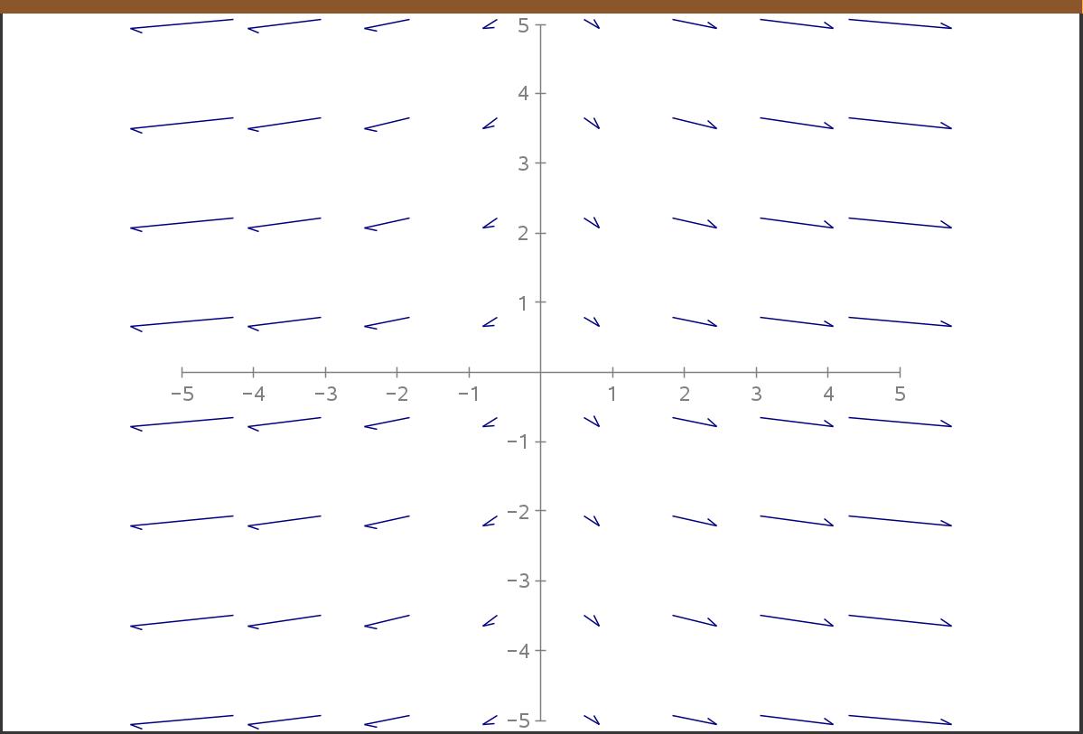

    3. 사용 방법
    update_vfield(xeqn, yeqn, xminmax, yminmax, grid, ticklabels)
    xeqn - a string. The equation or constant for the vector x coordinate.
    yeqn - a string. The equation or constant for the vector y coordinate.
    xminmax - a list. The min and max x axis coordinates for the graph: {minx,maxx}. The interval must include 0 as an internal value or endpoint.
    yminmax - a list. The min and max y axis coordinates for the graph: {miny,maxy}. The interval must include 0 as an internal value or endpoint.
    grid - a number. The number of grids from 2 up to 8. For a grid value of 8, the grid is an 8 by 8 grid, resulting in up to 64 vectors per graph. The center point of the vectors are calculated at the points where the horizontal and vertical grid lines intersect.
    ticklabels - a boolean value. If true, labels for the x and y axis tickmarks are displayed.
    4. 사용 예시
    f(x,y) = x^2-y 일 때
    update_vfield("2x","-1",{−5,5},{−5,5},8,true)

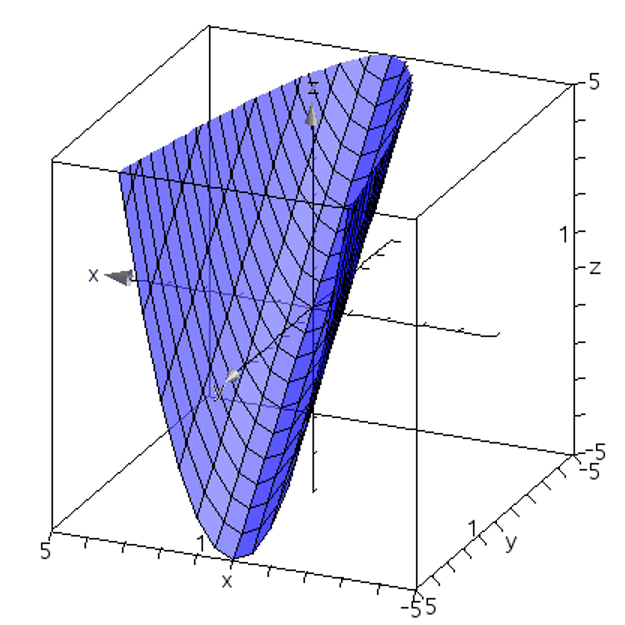

    아래 3D graph 는 참고용으로, 위 프로그램에는 포함되어 있지 않습니다.
    ( graphing page 에서 수동으로 그리실 수는 있습니다)

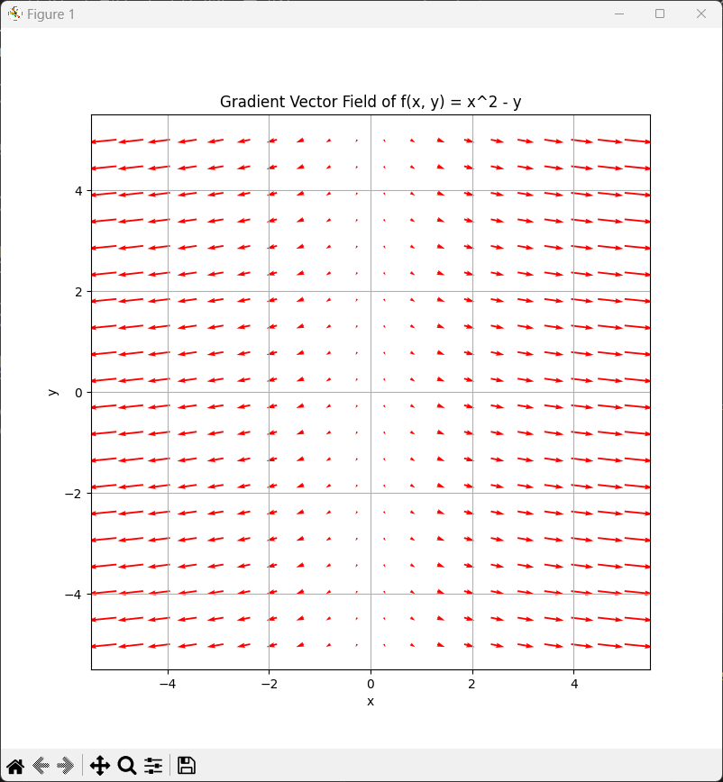

      2024.07.19 - 17:43 #44547
      비교 (python)
      import numpy as np
      import matplotlib.pyplot as plt
      # x와 y 값의 범위와 격자를 정의합니다.
      x = np.linspace(-5, 5, 20)
      y = np.linspace(-5, 5, 20)
      X, Y = np.meshgrid(x, y)
      # 그라디언트 벡터를 계산합니다.
      U = 2 * X  # ∂f/∂x = 2x
      V = -1     # ∂f/∂y = -1
      # 벡터 필드를 플로팅합니다.
      plt.figure(figsize=(8, 8))
      plt.quiver(X, Y, U, V, color='r')
      plt.title('Gradient Vector Field of f(x, y) = x^2 - y')
      plt.xlabel('x')
      plt.ylabel('y')
      plt.grid()
      plt.show()
      image.png 75.6KB 15
