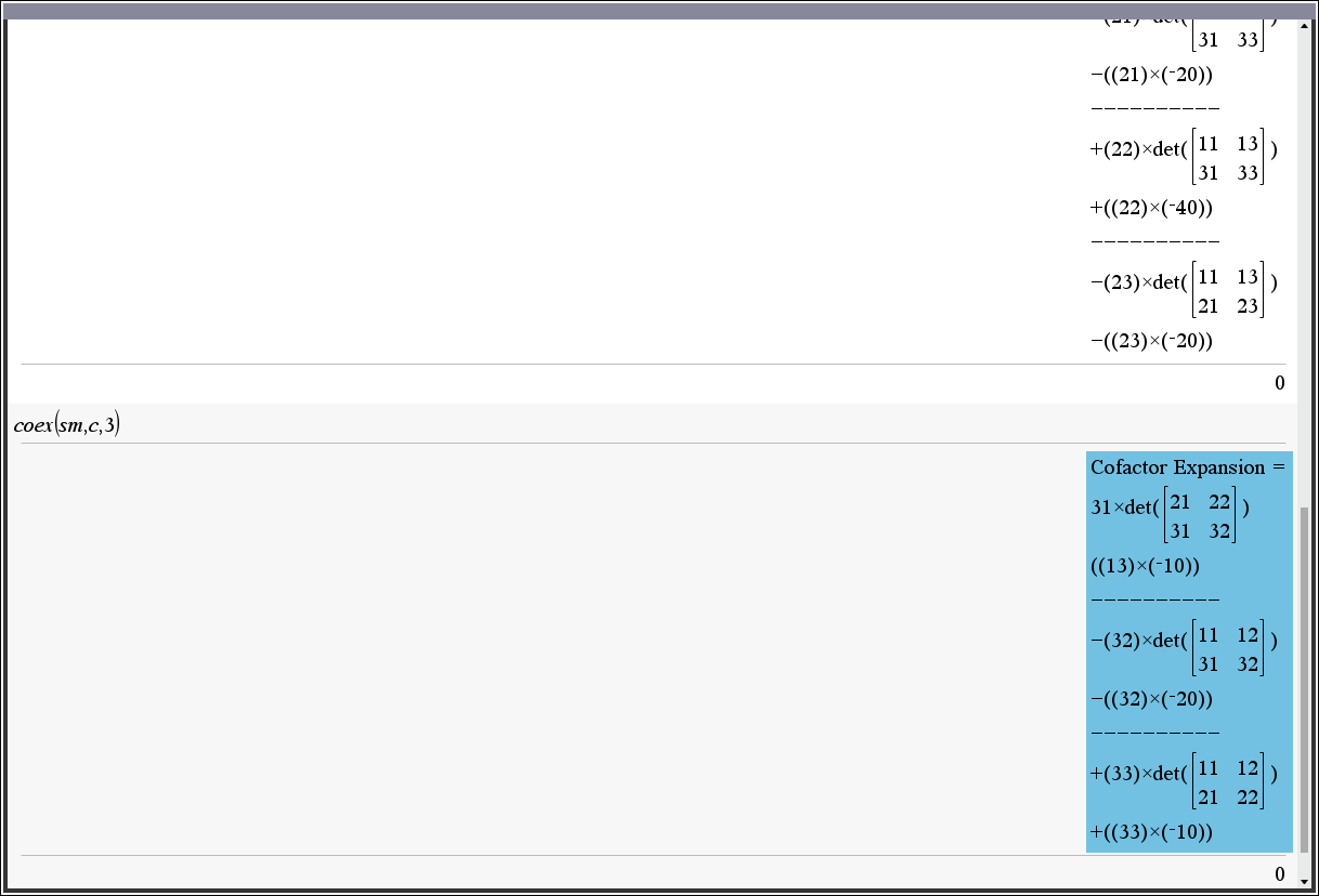

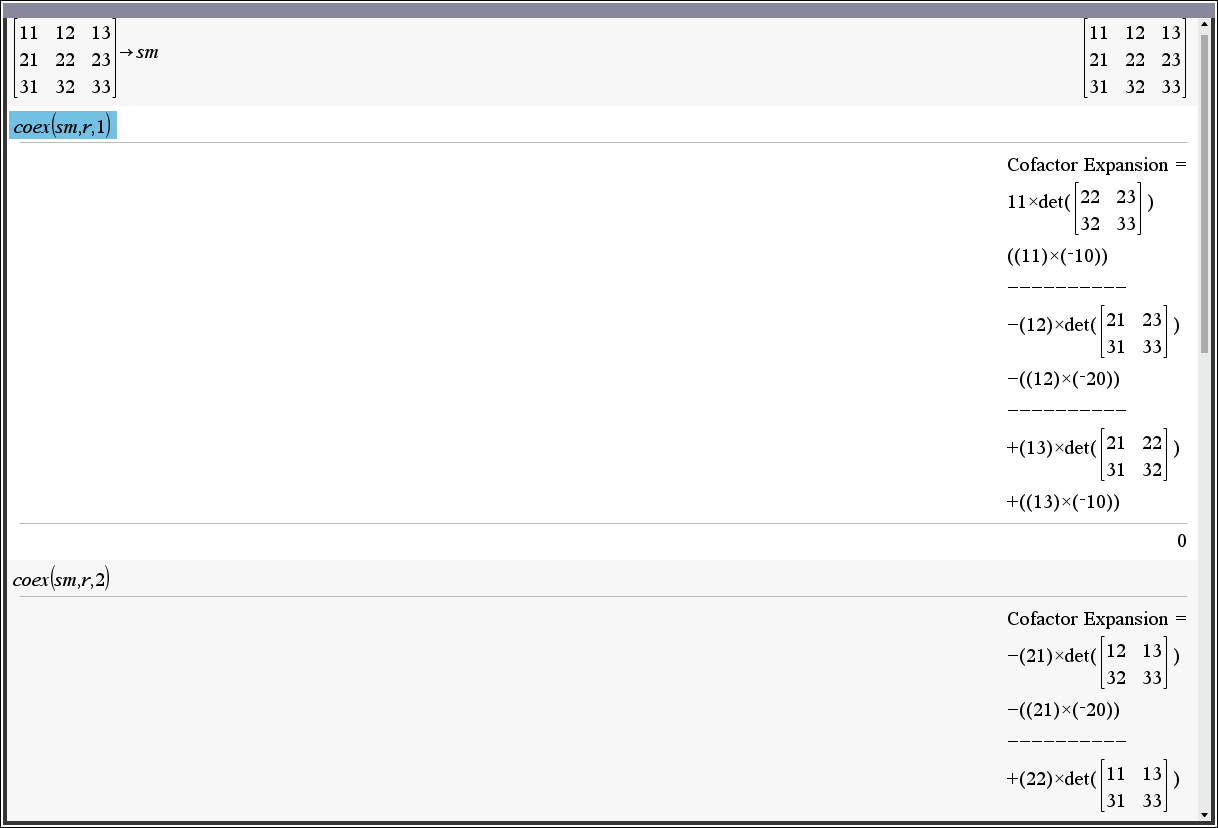

      2024.10.21 - 14:54 2024.10.21 - 13:53 #50814
      여인자 전개 프로그램 수정 V1.5
      Define LibPub coex(mat1,choice,index)=
      Func
      :© coex(matrix,r or c,index)
      :© Initialize
      :Local mat1_dim,i,j,co.result,minormat,sgn
      :dim(mat1)→mat1_dim
      :newMat(mat1_dim[1],2)→co.result
      :©Main Body
      :Disp "Cofactor Expansion ="
      :If string(choice)="r" Then
      :  If 1≤index≤mat1_dim[1] Then
      :    For j,1,mat1_dim[2]
      :[mat1[index,j],cofactor(mat1,index,j)]→co.result[j]
      :      minormat:=delete(mat1,index,j)
      :      sgn:=(−1)^(index+j)
      :      If j=1 Then
      :        If sgn=1 Then
      :        Disp string(mat1[index,j])&"×det(",minormat,")"
      :        Disp "(("&string(mat1[index,j])&")×("&string(minor(mat1,index,j))&"))"
      :        Else
      :          Disp "-("&string(mat1[index,j])&")×det(",minormat,")"
      :          Disp "-"&"(("&string(mat1[index,j])&")×("&string(minor(mat1,index,j))&"))"
      :        EndIf
      :      Else
      :        Disp "----------"
      :        If sgn=1 Then
      :          Disp "+("&string(mat1[index,j])&")×det(",minormat,")"
      :          Disp "+"&"(("&string(mat1[index,j])&")×("&string(minor(mat1,index,j))&"))"
      :        Else
      :        EndIf
      :      EndIf
      :    EndFor
      :  Else
      :    Disp "Invalid Row Index"
      :  EndIf
      :ElseIf string(choice)="c" Then
      :  If 1≤index≤mat1_dim[2] Then
      :    For i,1,mat1_dim[1]
      :[mat1[i,index],cofactor(mat1,i,index)]→co.result[i]
      :      minormat:=delete(mat1,i,index)
      :      sgn:=(−1)^(index+i)
      :      If i=1 Then
      :        If sgn=1 Then
      :          Disp string(mat1[index,i])&"×det(",minormat,")"
      :          Disp "(("&string(mat1[i,index])&")×("&string(minor(mat1,i,index))&"))"
      :        Else
      :          Disp "-("&string(mat1[index,i])&")×det(",minormat,")"
      :          Disp "-"&"(("&string(mat1[index,i])&")×("&string(minor(mat1,index,i))&"))"
      :        EndIf
      :      Else
      :        Disp "----------"
      :        If sgn=1 Then
      :          Disp "+("&string(mat1[index,i])&")×det(",minormat,")"
      :          Disp "+"&"(("&string(mat1[index,i])&")×("&string(minor(mat1,index,i))&"))"
      :        Else
      :        EndIf
      :      EndIf
      :    EndFor
      :  Else
      :    Disp "Invalid Column Index"
      :  EndIf
      :Else
      :  Disp "Invalid Choice : Input ""r"" or ""c"" for 2nd argument"
      :EndIf
      :© Finalize
      :Return det(mat1)
      :EndFunc
      사용 예시
      image.png 35.9KB 17 image.png 35.1KB 24
