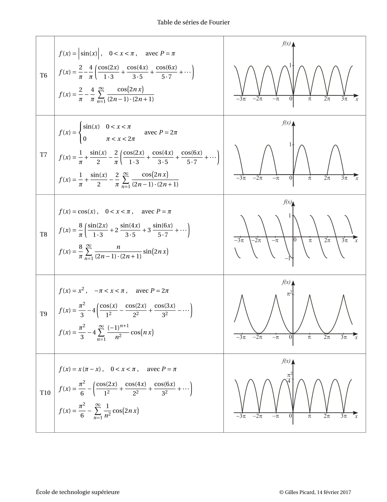

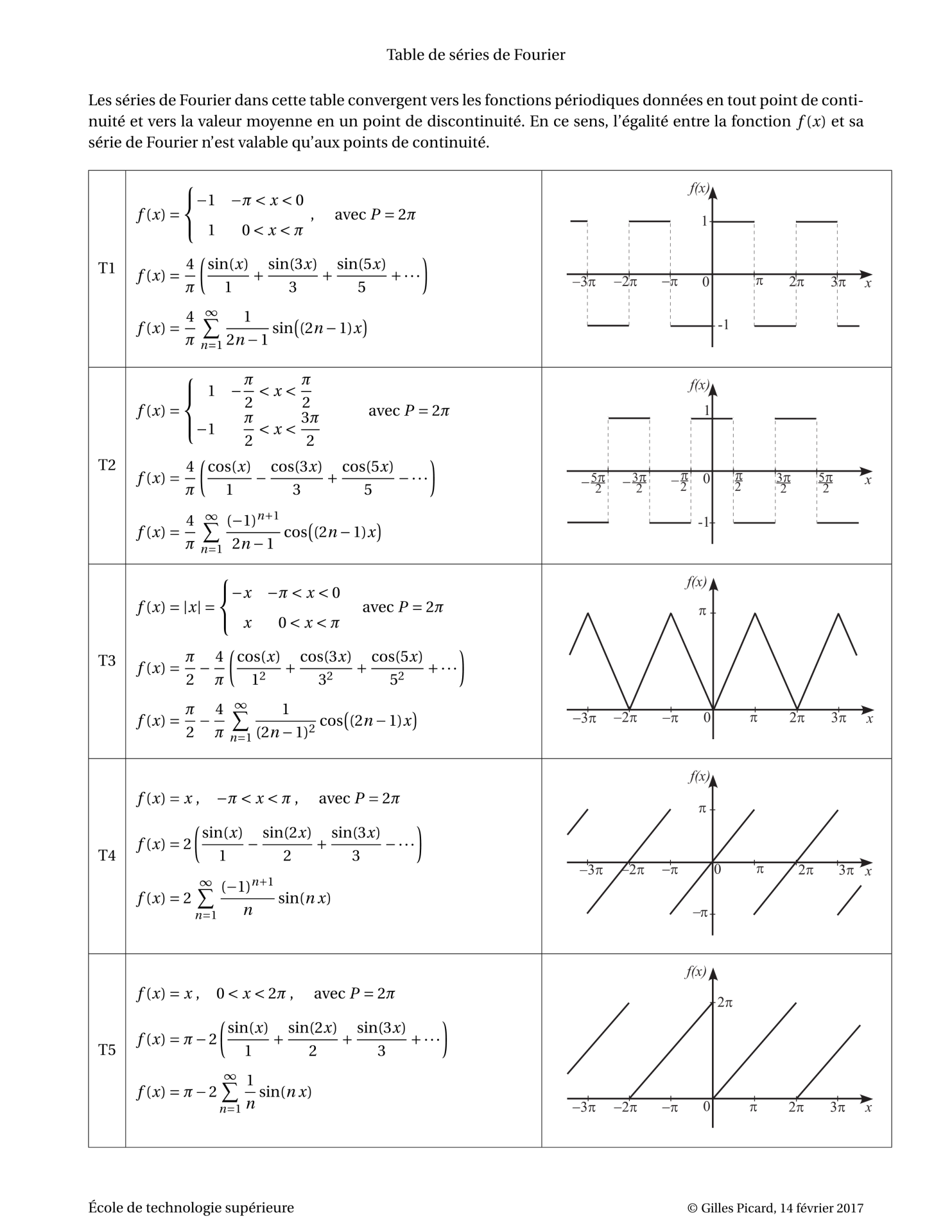

    • 푸리에 급수 테이블 , 푸리에 변환 테이블, Fourier Series Table, Fourier Transform Table

    출처 : https://ena.etsmtl.ca/pluginfile.php/137982/mod_resource/content/8/Fourier-table.pdf

    Fourier-table.pdf 56.0KB 21Fourier-table_1.png 353.7KB 20Fourier-table_2.png 351.6KB 26
