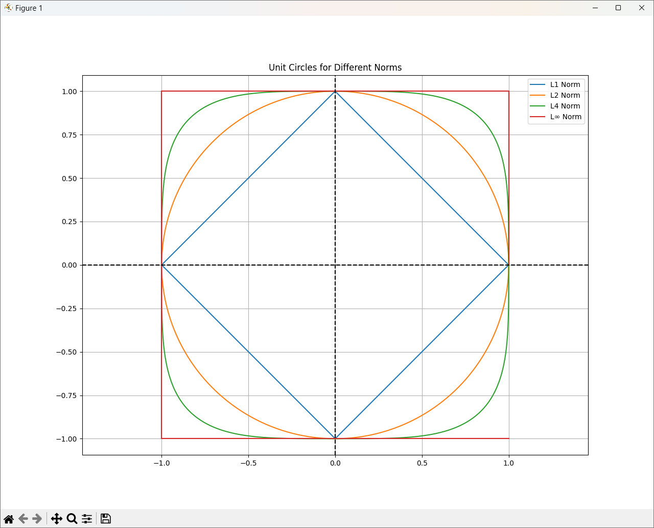

        그래프로 알아본 벡터 노름
        import numpy as np
        import matplotlib.pyplot as plt
        def unit_circle(p, num_points=1000):
            t = np.linspace(0, 2*np.pi, num_points)
            x = np.sign(np.cos(t)) * np.abs(np.cos(t))**(2/p)
            y = np.sign(np.sin(t)) * np.abs(np.sin(t))**(2/p)
            return x, y
        plt.figure(figsize=(10, 10))
        # L1 Norm (Manhattan)
        x1, y1 = unit_circle(1)
        plt.plot(x1, y1, label='L1 Norm')
        # L2 Norm (Euclidean)
        x2, y2 = unit_circle(2)
        plt.plot(x2, y2, label='L2 Norm')
        # L4 Norm
        x4, y4 = unit_circle(4)
        plt.plot(x4, y4, label='L4 Norm')
        # L∞ Norm (Maximum)
        xinf, yinf = unit_circle(np.inf)
        plt.plot(xinf, yinf, label='L∞ Norm')
        plt.xlim(-1.1, 1.1)
        plt.ylim(-1.1, 1.1)
        plt.axhline(y=0, color='k', linestyle='--')
        plt.axvline(x=0, color='k', linestyle='--')
        plt.title('Unit Circles for Different Norms')
        plt.legend()
        plt.grid(True)
        plt.axis('equal')
        plt.show()
        스크린샷 2024-07-19 174553.png 84.9KB / 9
