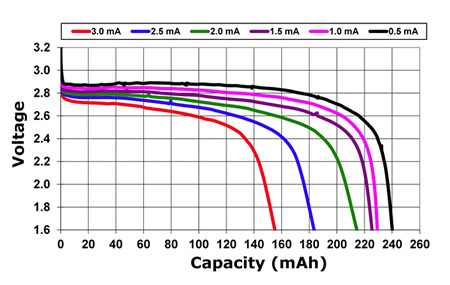

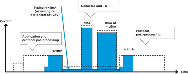

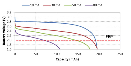

      2024.06.29 - 15:27 2016.04.12 - 14:22 #17355
      FEP (Functional End Point) 전압
      • http://www.low-powerdesign.com/121312-article-extending-battery-life.htm
