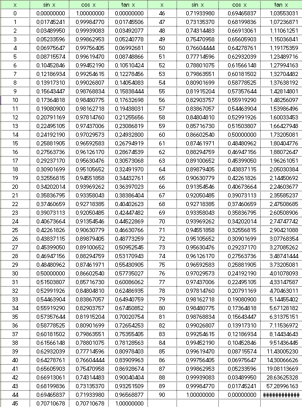

      삼각함수표
      ( 출처 : http://netp.tistory.com/6)
      itrig1.png 18.1KB 346

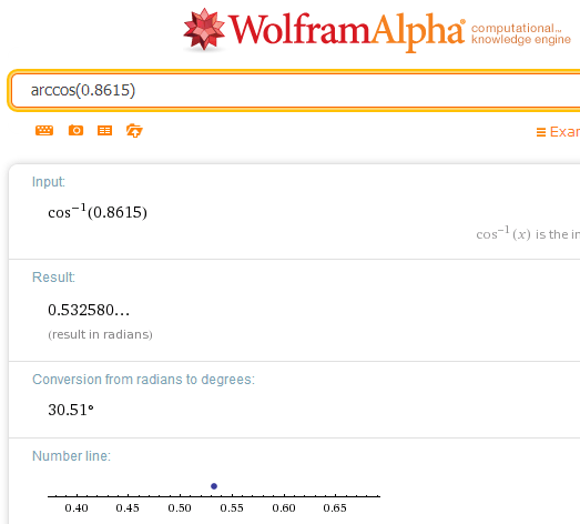

      울프람 알파(Web)
      http://www.wolframalpha.com/input/?i=arccos%280.8615%29
      itrig3.png 9.6KB 445
